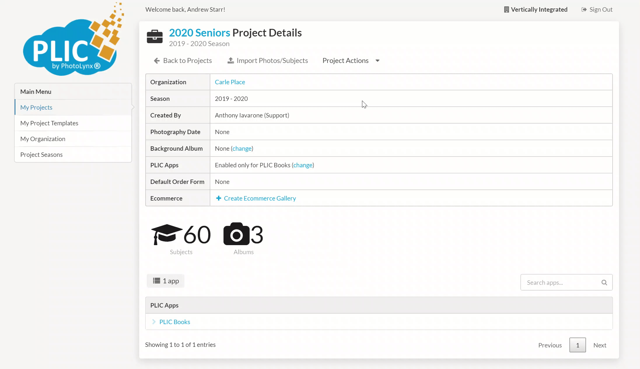

After you've got a Project in PLIC you're ready to push, open the Project and click on + Create ECommerce Gallery. You'll be asked to specify the Order Form and E-Commerce Provider for the Project.
You can also toggle if the gallery will be used with green screen images. Ensure this is toggled correctly as it cannot be changed once pushed to Workflow.
Once done, you'll be taken back to the Project Details screen with a notification that your gallery is being published to Workflow.
