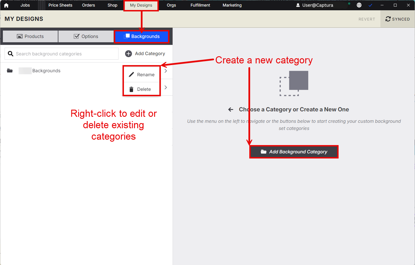

Inside the My Designs tab, click on Backgrounds to access your Background Categories. Background Categories are used to group multiple Background Sets together - usually categorized by season (ie. Fall/year - Background Sets).
โ—Warning: You'll need to create at least one background category before you can create a background set. Click on the plus/+Add Category button to create a new category.
๐Ÿ“ Consider using categories for:
  • Season
  • Sports
  • Standard (free)
  • Abstract
  • Premium
  • Location-specific

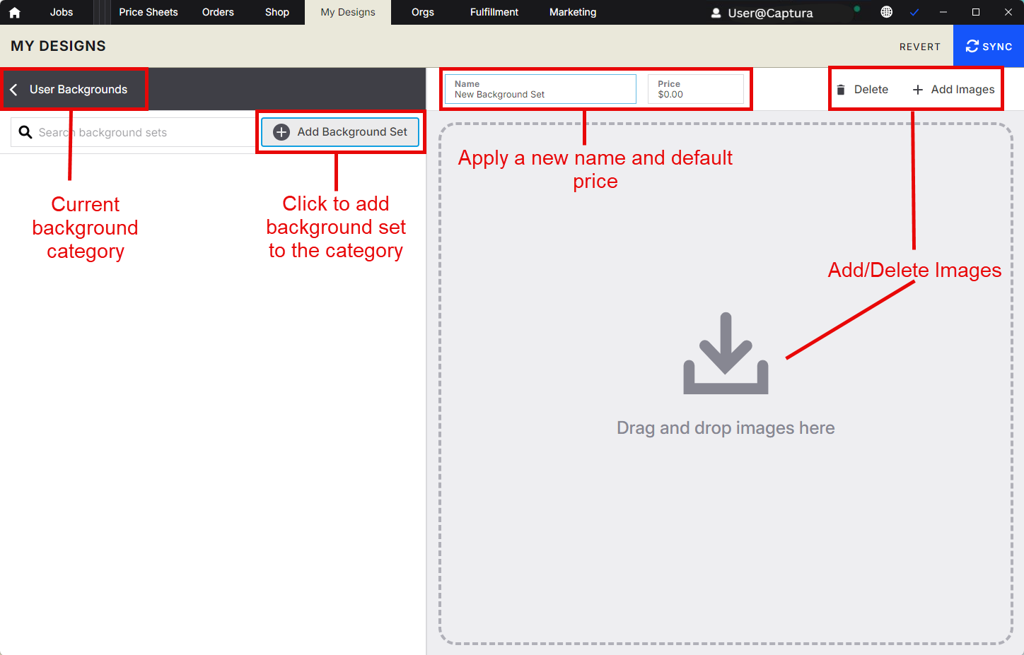

Open a background category to begin creating a background set:
Along with adding images, you can add the following information to a background set:
Name
๐Ÿ“ข Attach custom names and prices to background sets to help distinguish them from one another and upcharge on more popular or location-specific designs.
Price
Set the default price of the product. While it may be the default price, this attribute can always be changed on the price sheet.
Default of $0 is acceptable.
Note: You can add as many images to a background set as needed

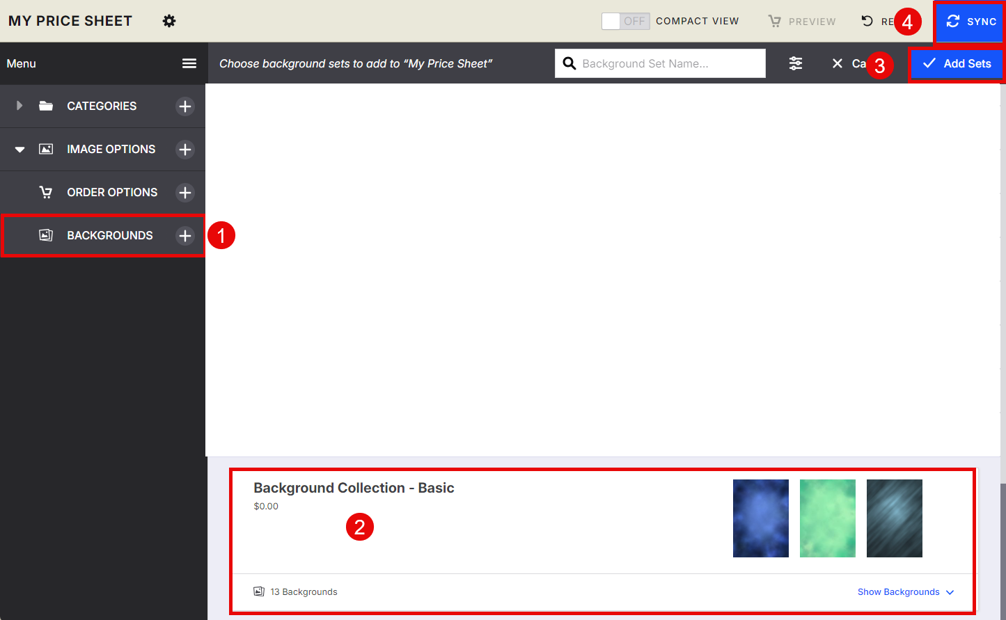

How do I use my background set?
Inside a Price Sheet, add your background set or sets:
  1. Click the plus/+ button to open your background sets
  2. Select your backgrounds
  3. Click Add Sets
  4. Click Sync
โ€‹

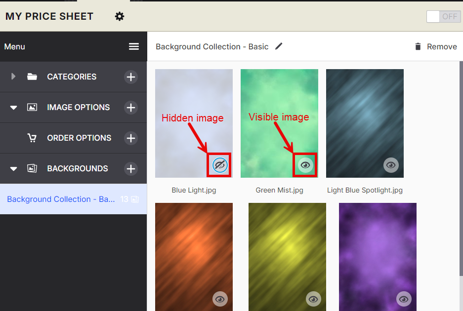

NOTE: You can click on the eye icon to hide a background in the set from the gallery
