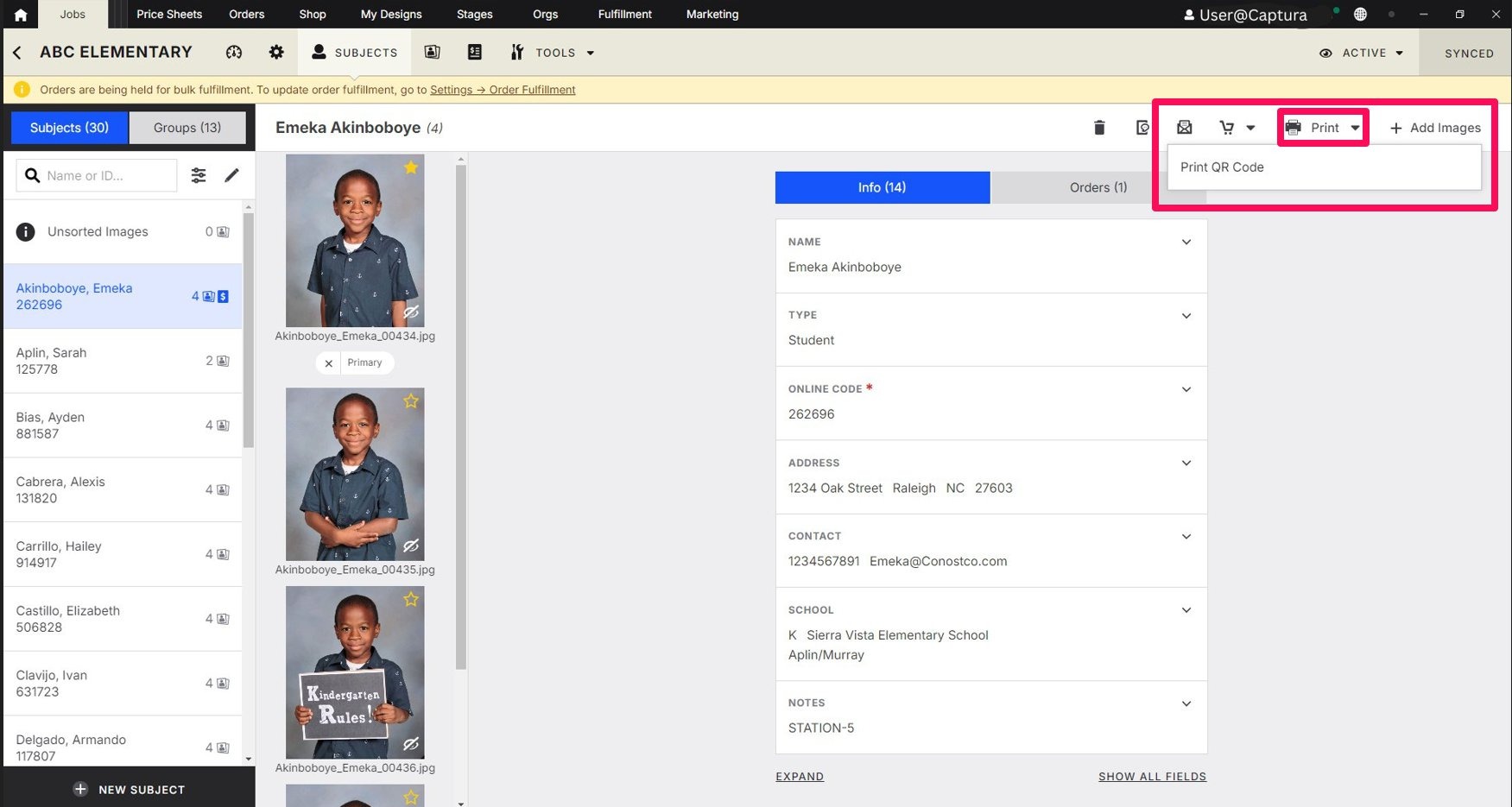

Printing a single QR Code
Select a subject from a job and click Print > QR Code:

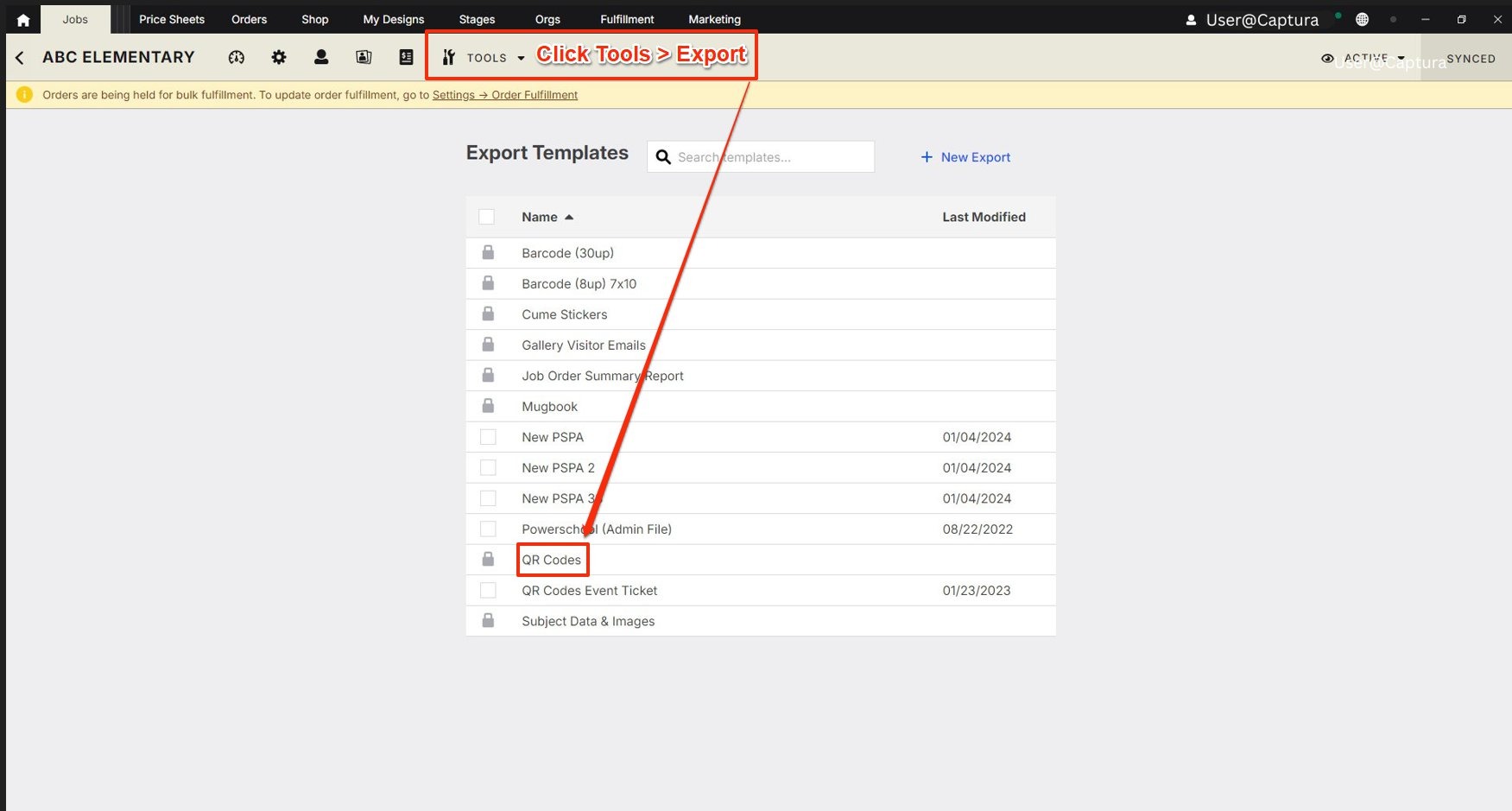

In a job, click on Tools > Export > QR Codes:
Workflow will prompt you to set up the sorting, grouping, designing of your QR Codes before they can be exported. See Sorting, Grouping, and Designing the QR Code for more information.

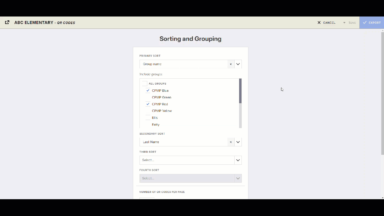

Step 2: Configure Sorting and Grouping
The "Sorting and Grouping" section allows you to organize your QR code export based on your collected job data.
  1. Primary Sort:
    • You have access to all data collected within the job.
    • You can restrict the export to specific groups by using the "group name" filter, ensuring only relevant QR codes are generated for those groups.
  2. Number of QR Codes per Page:
    • Specify how many QR codes you wish to print on each page. This helps optimize printing and paper usage.
  3. Stack Sort (for paper cutting):
    • Enter the number of sheets your paper cutter can efficiently cut at once. This helps in batch processing and preparing the printed QR codes for distribution.
  4. Split Multiple PDFs by Group Name:
    • Check this option if you want to generate separate PDF files for each group. This can be useful for organizing and distributing QR codes to specific groups independently.
  5. Click Next to proceed.

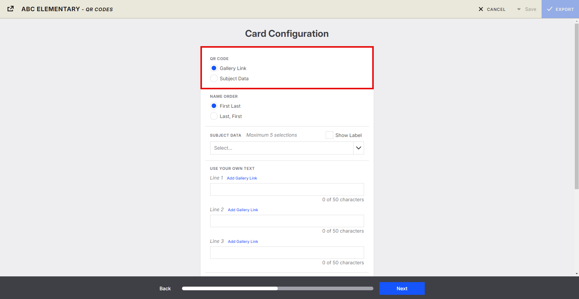

Step 3: Customize Card Content
In the "Card Configuration" section, you can define what information will be displayed on each QR code card. As you make selections, you will see a live preview of the QR code update, allowing you to visualize the final output.
  1. QR Code Functionality:
    • Subject ID or Gallery Link: This is a crucial setting. If you select "Gallery Link," subjects will be able to scan their unique QR code to directly access their online photo gallery.
  2. Content Customization:
    • Add Custom Text: You can include static text on the card for additional information.
    • Bring in Dynamic Data Fields: Leverage the data you've collected by adding dynamic fields (e.g., subject name, grade, etc.) that will pull specific information for each individual QR code. This allows for personalized cards.
    • Add Subject's Gallery Link: This option specifically allows you to embed the direct link to the subject's online gallery onto the card.

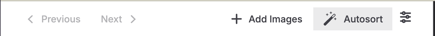

Click Tools > Sort. Once in, select +Add Images to add your images to the tool or drag and drop the images.
Once images are in place, click the Autosort button.
Workflow will now process and sort all images to their respective subjects:

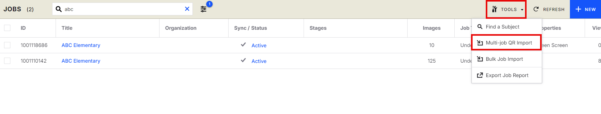

Multi-Job QR Import tool
The Multi-Job QR Import tool lets you sort and assign images to subjects/groups from multiple jobs in one motion. Copy all the images from multiple camera cards into one folder before starting.
From the Jobs tab, select Tools > Multi-Job QR Import:
Select a folder that contains QR workflow images and select Autosort.
Afterwards, the tool will let you:
  • Review and correct any image assignment as needed
  • Save a report of all images assigned/unassigned
  • Sync to upload images to cloud

Can subjects use the QR Codes to access the gallery?
Yes! Make sure the card is configured with the QR Code type Gallery Link:

Can I export QR Codes for a specific group/grade?
Yes!
Setting your primary sort to Group Name will allow you to specify which group(s) to use the export with. Just group your subjects in Captura Workflow before starting the export.
