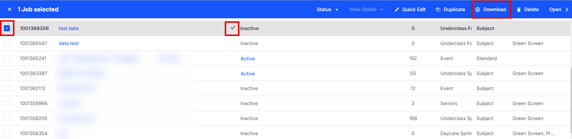

To make a job available offline while you're working in the field without internet access:
  1. Select the job you want to download
  2. Click Download
  3. Once the download is complete, a tick will appear in the Sync/Status column to show the job is available offline
This lets you continue working even when you don’t have an internet connection.

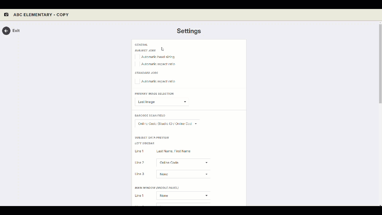

What other settings can I edit?
Enabling watching on the hot folder is the bare minimum needed for setup.
There are additional settings available to configure:
Setting
Detailed
Automatic head-sizing
  • Captura Workflow looks for the subject's unique facial features and applies corresponding head sizing as images are pulled in from your hot folder.
Automatic aspect ratio
Select from the following aspect ratios to apply to each image automatically:
  • 2:3 (4x6)
  • 2.5:3.5 (5x7)
  • 4:5 (8x10)
  • 1:1 (10x10)
Primary image selection
Decide if the first or last image should be set as the subject's primary image.
Barcode scan field
Choose the subject data field embedded in your exported barcodes to have Captura Workflow automatically select that subject when scanned.
Available data fields to choose from are:
  • ID (System ID)
  • Online Code
  • Subject ID
  • Custom Data 1
  • Custom Data 2
  • Custom Data 3
Subject listing
Choose which subject-data fields you want to see in the subject list.
Subject data preview
Select up to five different data fields to make visible in the middle pane when a subject is selected. These data fields can be updated on the fly as subjects come up to the chair.

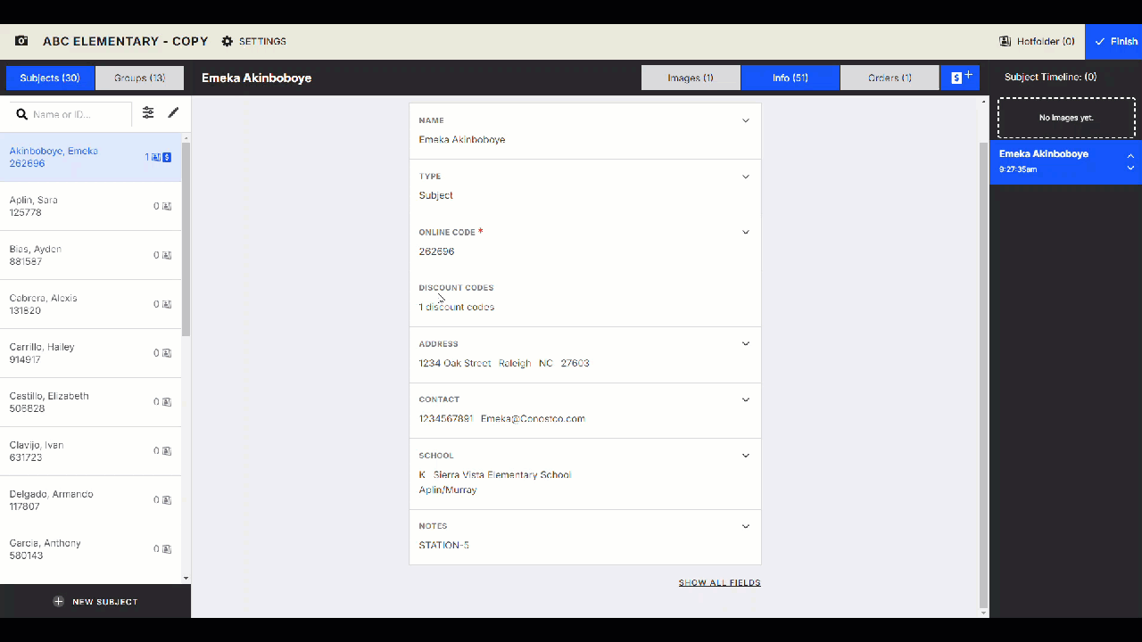

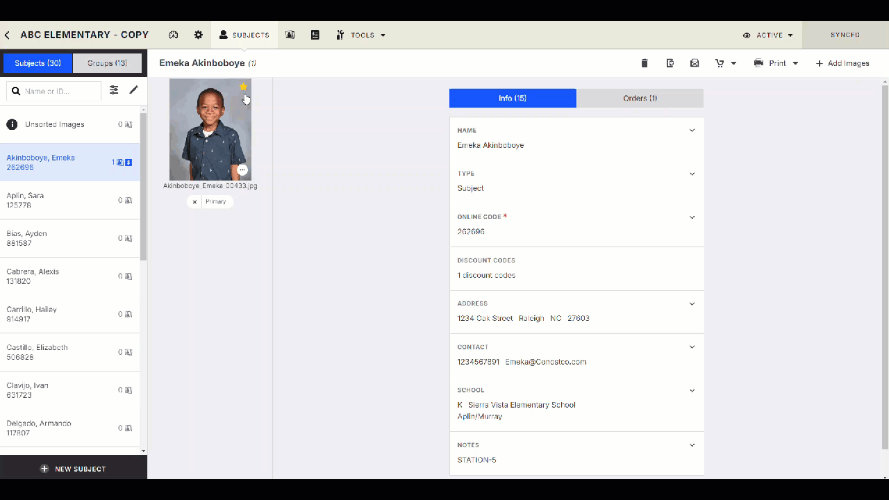

You can easily create, edit or delete your subjects. After selecting a subject, click the Info tab to see all of your used subject data fields.
Here, you can edit or add any data you’d like. At the bottom of the Info tab, you can SHOW ALL fields to see all subject data fields available:
You can also create a new subject on the fly by using the New Subject button at the bottom-left corner of the application.

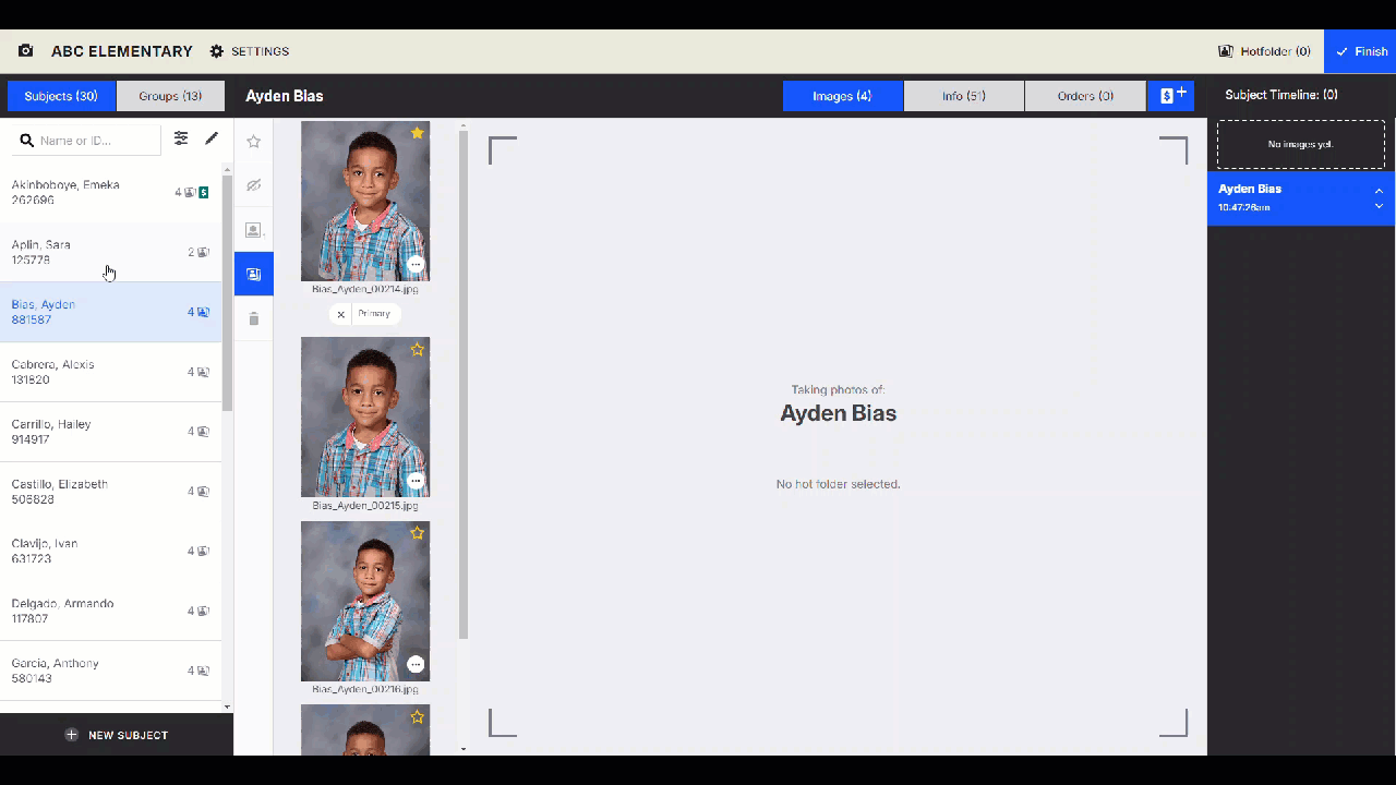

Use the filter button to apply filters to the subject list beside the search bar. As you photograph each subject, the list will filter out any applicable subjects instantly:

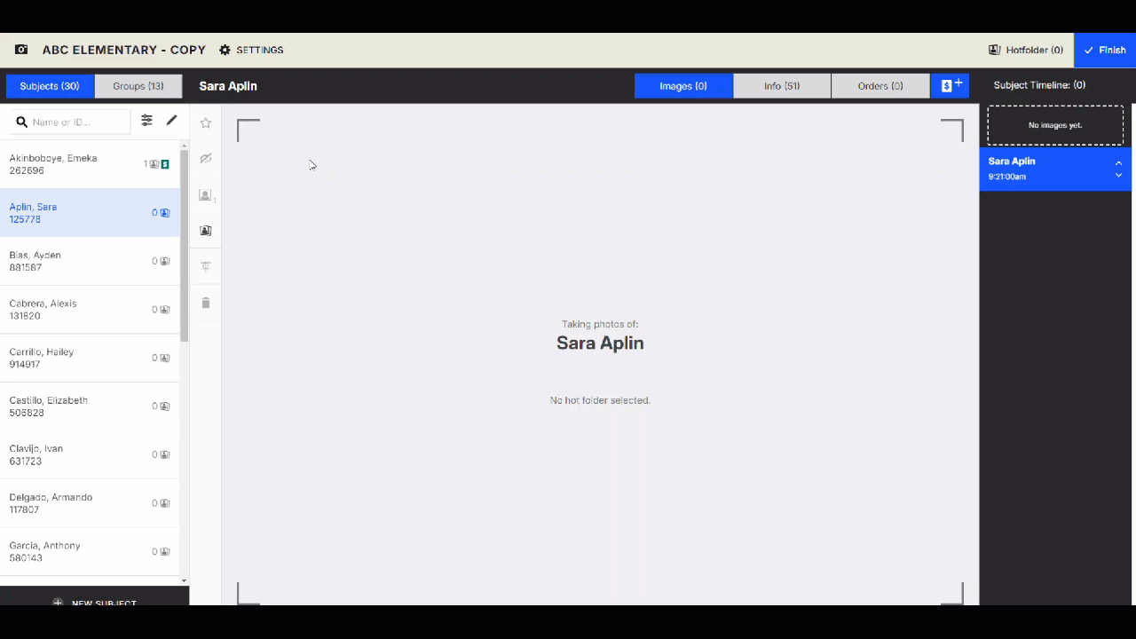

Taking photos while tethered

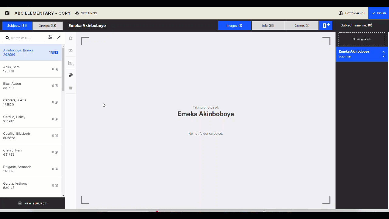

Once the subject is chosen or scanned, you're ready to take pictures. Take as many images as you’d like before moving on to the next subject. As you take pictures, you will see the image appear in the center pane and in the Subject Timeline on the right-hand side.
❗The subject timeline only shows thetimeline of the current session.
You can zoom in or out, change the aspect ratio on the bottom toolbar. The left toolbar also has several options to choose from.

Subject timeline
A timeline of images taken in session is locked to the right-side of the app.
It shows the timestamps of subjects as they came to the station and what images were taken.
You can drag-n-drop images from the timeline between subjects to quickly resolve mix-ups.

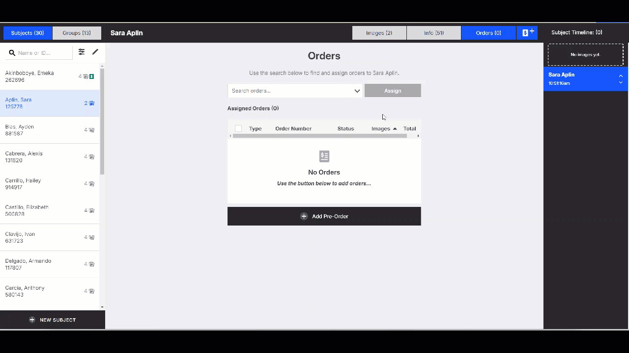

Order entry
Click the blue $+ button in the top-right to quickly enter any orders as needed:
In order entry, you’ll need to do the following to complete an order:
  • Choose the packages and options needed to create their order.
  • Select card (internet required) or use the default payment method cash/check.
    • Cash/Check orders have 0% commission
  • Capture any discount codes, order notes or shipping information (if applicable)
📝 Note: Captura Workflow will not store any card information on your device.
