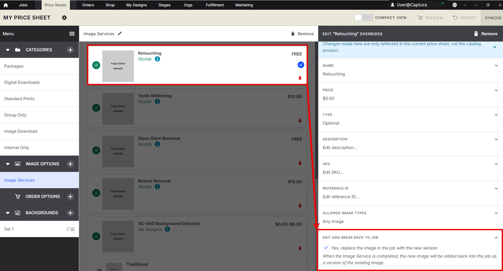

Setup your price sheet's services to return the image back into the job
Inside a price sheet, select an image option and turn on Edit Add Image Back To Job:
What happens after the image service is completed?
The serviced image will be attached to the order for fulfillment and will appear as a versioned image of the original in your job.
The versioned image will also be on "top of the stack" - meaning the customer can view and reorder the new image immediately. The new image will carry over all of the attributes, such as Primary/Yearbook 1/Yearbook 2, and will be automatically ready for your exports.

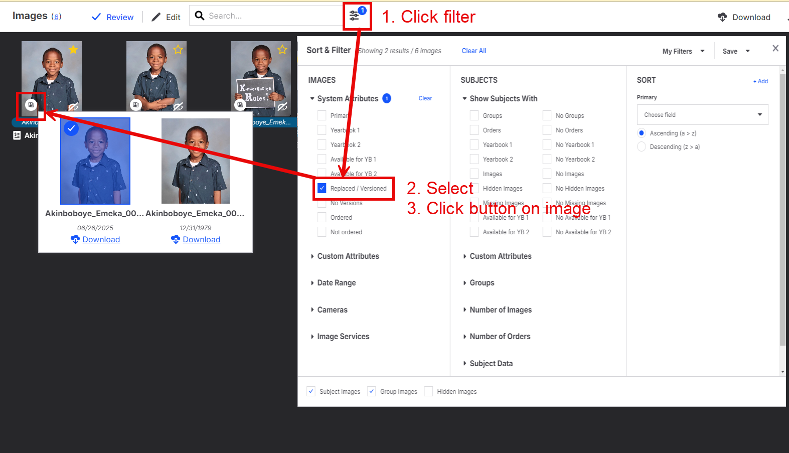

How can I view the images?
Smart Workflow members can filter images with image versions, and click on the picture icon to view different versions:
